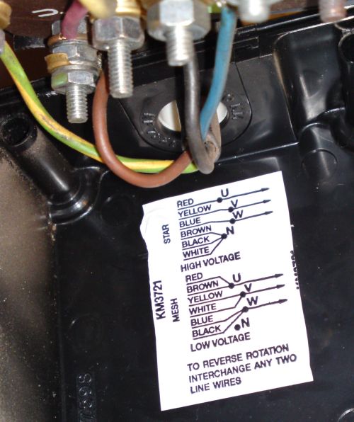

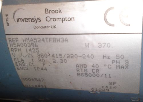

Power - Recently new motor, on the label it states two voltages, so must be dual voltage motor yes ??
Also on inside of wiring for the motor, it shows high and low voltage wiring..
So theorhetically I could wire it direct to 240v, without the inverter ???
