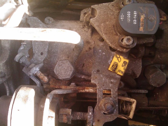

Got the pug/citroen dw8 engine (1.9d) in her car, its a '53.
When its reallly very cold it cranks but takes a bit to start... it does start after 20 secs or so, but i get annoyed with minor things like that
First thought was heater plugs, so i changed them, not made any difference.
Checked the relay operation, it seems to be on for about 15 secs, voltage of about 11.7v. The plugs are marked 11v.
When it starts it seems to kick into action without chugging for a second or two, nor clouds of white smoke which i might expect if it were cold.
Starting from warm, its running as soon as the key is turned.
Reading up online earlier, sounds like the pump, mechanical type, has electronic advancment control, i imagine this is something to do with the black bit top right in pic below?
How does one check this out, and the yellow bit marked 2.58v, whats that about??
I have some basic knowledge of these things, but far from a mechanic/auto electrician! So relies in simples please!!
