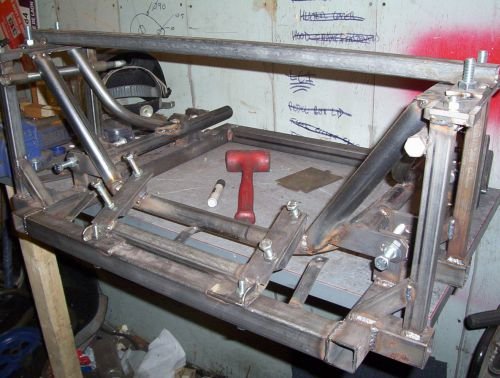

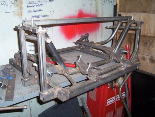

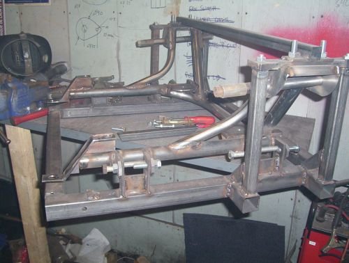

It turns out thee is a tubular subframe available in the states which would solve all the problems , but at $1095 (plus shipping and tax's) it is just too pricey - I took one look at a picture of it , and foolishly blurted out "looks dead easy to make , I could do that"............
So here I am , a week and a bit later with a finished jig sat on the bench and a bit of workshop time coming up over Christmas

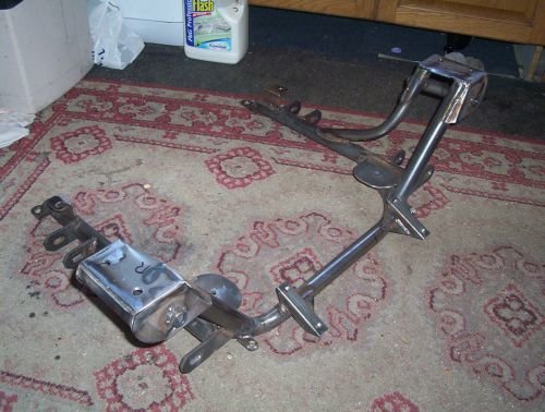

The original subframe has now been removed from the jig , but I am taking a couple of days off to work out the fine details before I start (oh , and to get Christmas over with as well !)
