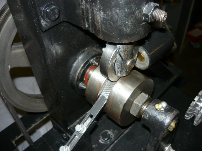

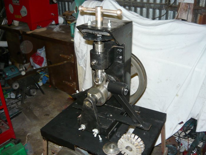

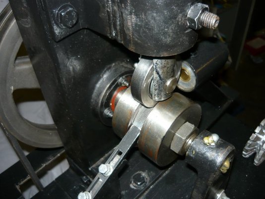

heres a scrap[ cable crusher and cutter ive made it crushes up to 25mm which splits the insulation from the conductor and just peels apart it also has slitting wheel for cutting armoured cable with the apropriate wheel disks. it will slice up to 4inch armoured running at 100rpm on a 2 horse motor and cut about 100m in 3mins the only thing needs finishing is guards and a quick kill switch as it wont stop if wire gets hold of u
