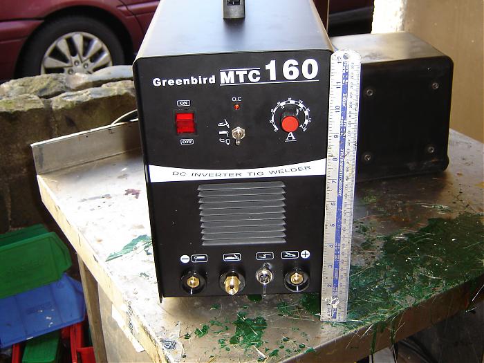

I can't weigh up exactly if it is for a scratch-start TIG torch or High-Frequency, push button type. I would imagine it to have a basic, scratch-start TIG facility but the socket next to the + outlet is throwing me. It illustrates the switch symbol which would normally be for the high frequency style torch or a foot switch. Maybe that's for the Plasma torch?

Does sound like an HF start TIG though. Next piece in the jigsaw puzzle, was it supplied with a plug to fit into that torch trigger socket? There's a multitude of different types so if there wasn't one supplied that is your first headache.

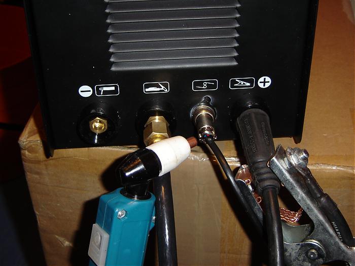

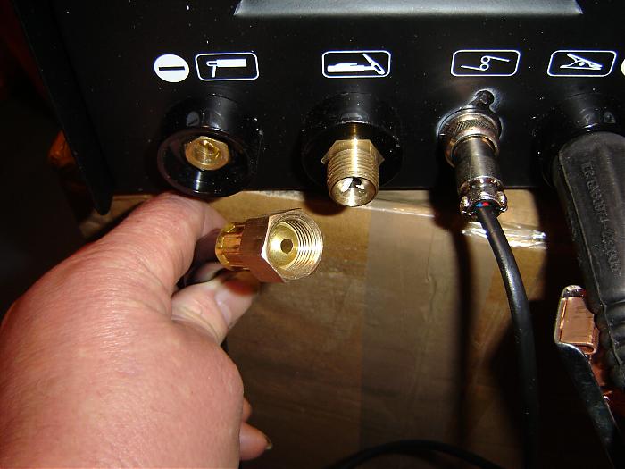

Here are pics of what is needed anyway. The unit has a connection to the left for the Arc torch. Because it is Tig and Cutter these use the same socket. So the cutting socket you see is the same as the tig torch one.
Just to answer my own question the earth lead goes to the positive. Only gleaned this by looking at Cut only machines from the same maufacturer.

Ok, i take it you've got the cut switch set to 'cut' and your not trying to cut with argon? Those chinese tig/plasma's share the same gas input hose at the back, connect this up to DRY!!!! air at 50psi or so and try it again.
Thanks Hugh. Switches seem to be set ok.Three positions. Air/gas inlet at rear of machine. There is a water trap set inline.Machine turns on ok and torch switch controls air flow on and off with a 2second delay. Fan works power on and off ok. It is pilot arc start. Should machine not make a constant clicking noise until arc is formed?
Just couldn`t get any power through the torch. When I left it down and came back I noticed moisture coming through the torch nozzle and had left a drip on the floor. Drained compressor well before start. no water gathered in percolator........is this the problem? The machine looks not badly put together but the manual is poor.
Just to update on machine.When turning it off....It frequently trips my 40amp breaker which none of my other machines do. HF pilot Arc system seems to be cheif suspect at the mo. I don`t have a Tig torch to try that function or the proper dinse socket to try it on ordinary arc function.and wont be buying them at the moment.
