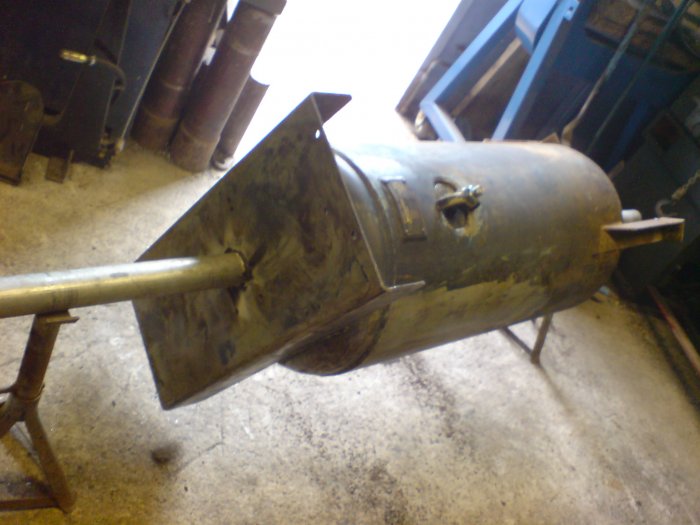

The receiver was a bit rusty inside so i welded a bit of tube each end, set them up on axle stands and put a few bits of scrap inside the tank. The scrap was put in through the inspection hatches and i sat there and turned it over and over for about half an hour.
This got rid of any loose rust. I was thinking of tipping some sort of sealer in when the rust was out, and giving it a spin to seal it. But i thought this was a bit over the top as the receiver is about 8 - 10 mm thick and the rust wasn't too bad. I worked it out as being around a 142 litre capacity ( it only had imperial dimensions on the data plate)
