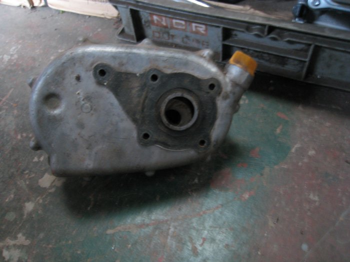

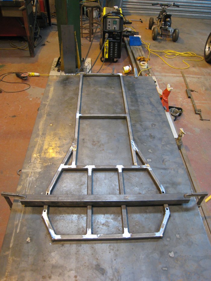

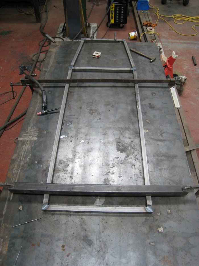

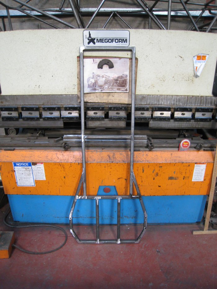

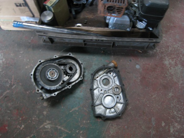

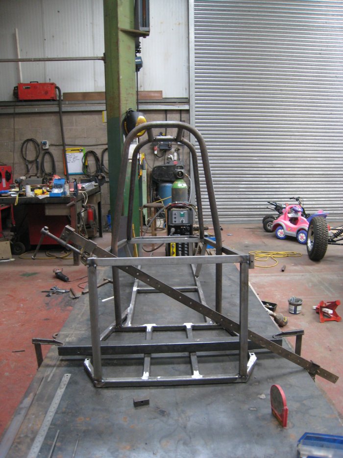

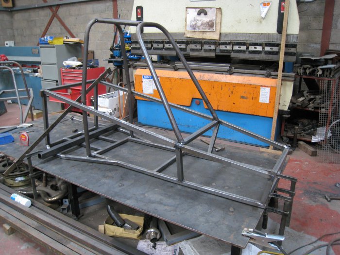

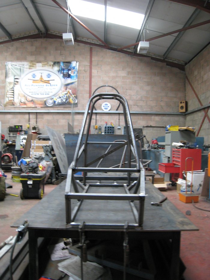

Waiting on parts and pipe to finish off my own buggie and under much pressure from the kids to start on their toy finally gave in this afternoon and made a start.

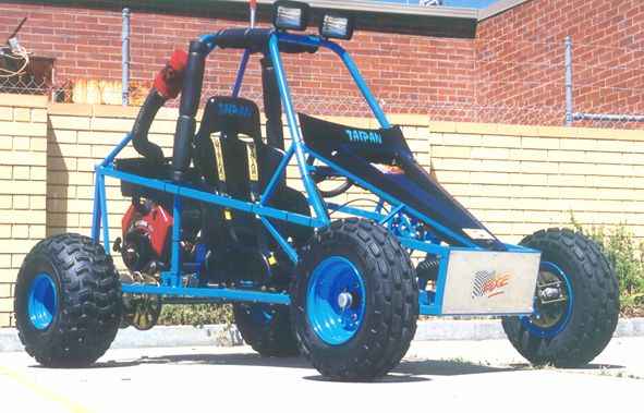

It will only have a 5.5hp twist and go motor for starters ( donated from a power washer I got free a couple of months ago) but is strong enough to take a 250 motorcycle engine at a later date, cut and welded the lower frame made from 30 x 30 x 3 box section have been gathering parts for a while only need disc brake hubs and wheels from a quad also a mini steering rack and column. Have also included what the finished project will look like.

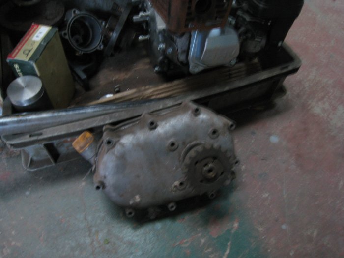

and it is a Honda industrial engine petrol driven same as what is used on generators, pumps,power washers.
