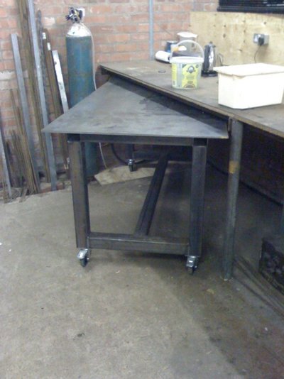

I've got a base made from box section that I'm looking to put a piece of plate on to make a welding bench.
Now all I need to know is how thick plate should I get and where should I get it from.
The base is 600mm x 1200 mm.
From reading the archives it I have gathered that 6mm is a minimum but 10mm would be better.
Searching ebay suggests that 600 x 1200mm in 10mm is going to cost a fortune.
I'd also like some overhang on the sides of the bench for clamping etc.
How much should say 750 x 1500 mm of 10mm plate set me back. Any likely sources?
Chas

But I still ended up making another bench with a thicker top for welding on and it really is much better. Although I confess that quite a bit of the improvement is because I can walk all around it.
I just hobby weld, so I've never wished the top was thicker.
