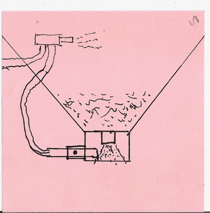

I'm really pleased with my extraction - just some 40mm waste pipe with a vacuum cleaner - but I guessed at an arrangement with the pipes to try to recover most of the blast media - and its brilliant.
I deliberately made the air go the 'wrong way' round those T joints and it results in it dumping the blast media down into the dead end pipes at the bottom.
I also fitted compression joints for those so they are easy to remove & empty back into the cabinet.
I fitted the upright pipe onto the air inlet as otherwise it whistled like you would not believe!
All the pipe bits were just from B&Q - the ones in the top of the cabinet are sold as a 'tank connector'.
