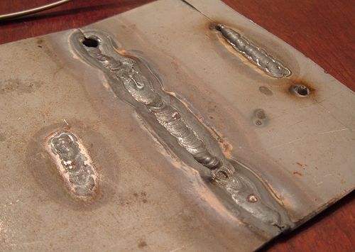

I've been playing with the TIG again today. The Miller education tips were very helpful, and I've started to develop a technique angling the torch forwards and welding towards the wire (otherwise the wire gets stuck and left behind!).
Started practicing on 0.8mm steel as it's easy to cut, and I managed a really TIG looking weld without filler rod. Addding a bit of filler rod the bead looked narrower and pointier than expected - too little heat probably.
Very keen to glue two bits of metal together so tried an overlap joint. This seemed very tricky as the arc kept jumping to the overlaped sheet and burned the edge away before I could persuade any filler to go in. Granted there was a little spacing between the sheets but it would have been no problem with MIG. Then the tungston started glowing red hot and I gave up. The arc was nicer with a reground tip, but seemed to go off quickly.
If it was MIG I'd tell myself to practice on 1.5mm sheet until I get the hang of it, so that's my plan. Also I'm not sure what kind of tungston I have in there so will buy some new ones (the one I have came with the welder and is getting very short). I'm a bit worried by the red hot tungston. For polarity I have earth connected to work and torch to electrode.
Any pointers would be much appreciated - I'm new to the TIG thing.
