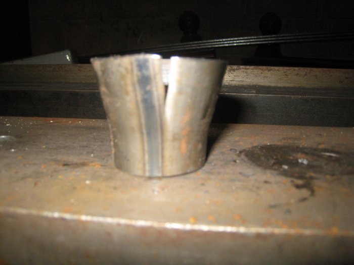

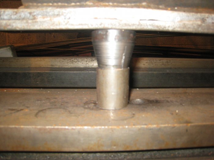

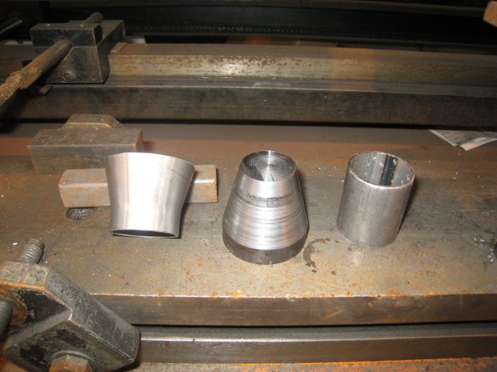

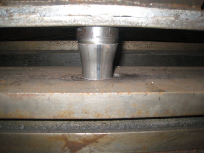

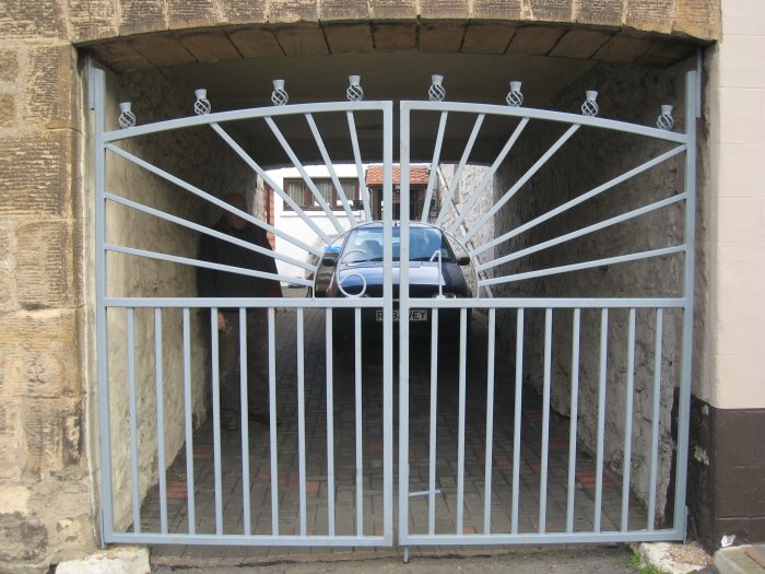

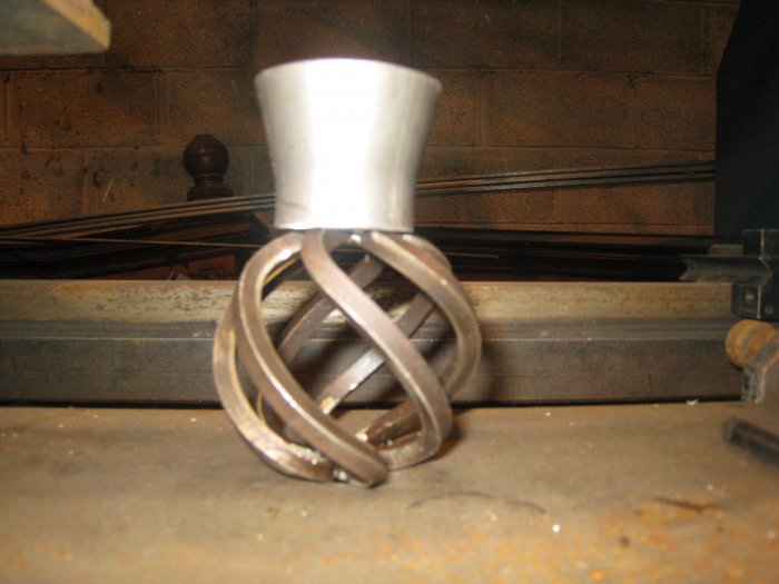

I have a client wanting a set of gates made and wanted thistles on top,so I bought some round baskets and made up tooling to press the tapered part at the top(Where the seeds live in real life).
The first one formed great but the second tore, this was caused by the welded seam marking the tooling and in turn causing a groove in the second one to be pressed and tearing at this point.
To overcome this I used oil and placed the marking on the tool at the seam every time which gave a good result. A wee lick o paint and it will look braw!!!
