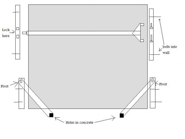

The car is nearly done so I am looking to secure the garage better due to living in a rough area.
The garage is a nearly brand new steel up and over door, secured to a wooden frame.
attached is my plan, made from box section, secured to the walls. Top bar swings over the bonnet of the car, but it will stop the car being wheeled out due to the roll bar height at the back of the car - it will also stop the door being forced in.
The two bottom bars swing over the corners of the door to stop them being kicked in. I'm thinking of fitting something to these bars to stop the door being pulled open.
anyway - not sure if this is a good design or not.
I have two weeks to make it as the car is out the garage for a few weeks getting work done to it, so replies will be gratefully received.
